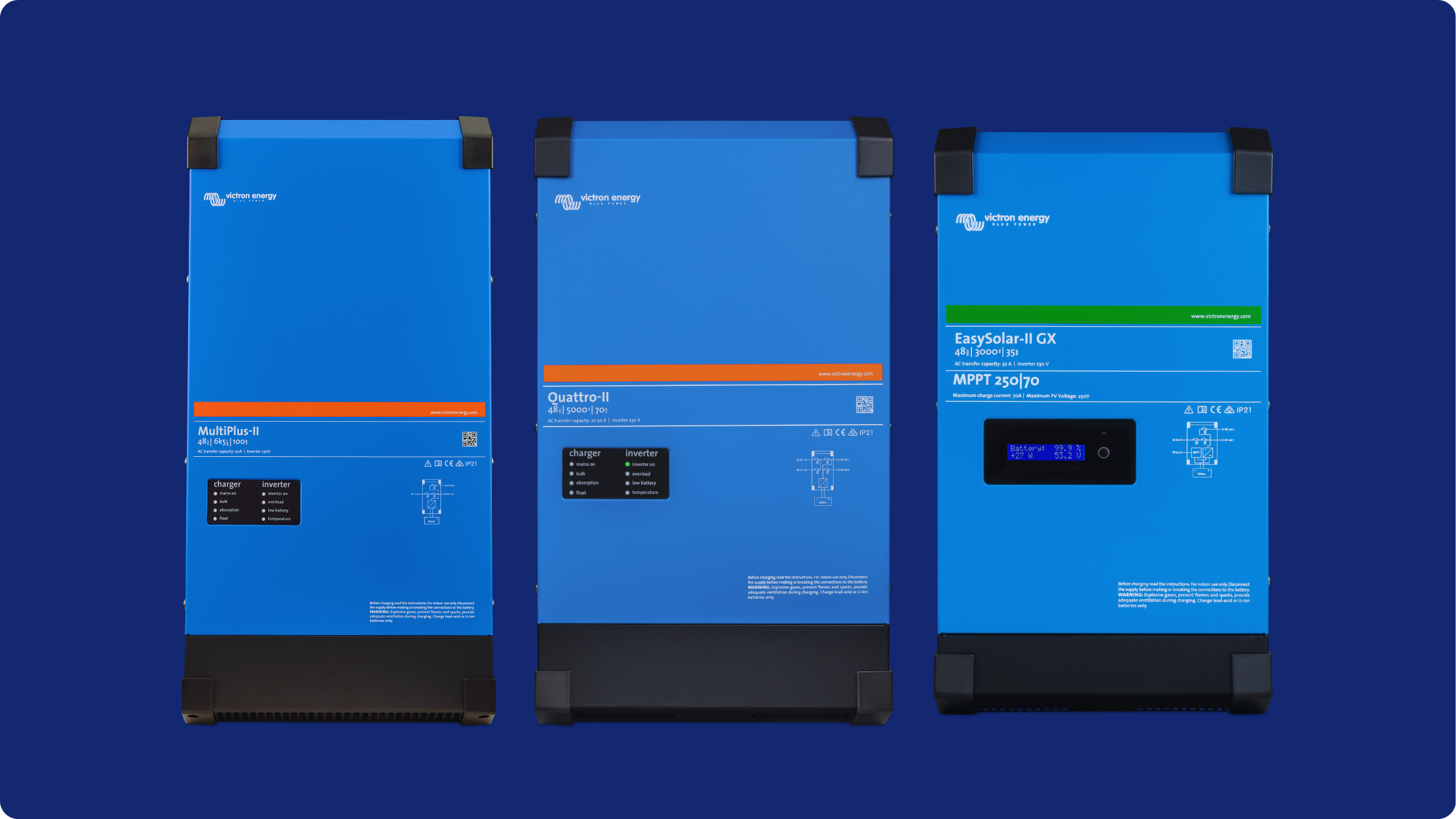

A VE.Bus firmware update is now available that fixes an issue where affected systems would briefly shut down. This affects some 48V models in the serial number range HQ2518 up to and including HQ2611.
The issue mainly occurs on systems using the Australian grid code or with the GND relay disabled. Aside from grid-connected systems in Australia, nearly all systems have their ground relay enabled and are therefore not affected.
The firmware is not available for all models, as only a limited number are affected by this issue. You can find the list of affected products below.
List of affected products
If your model is not listed, it does not exhibit this behaviour.
Firmware version
- v562: MultiPlus-II 48/8000
- v560: all other models in above list
