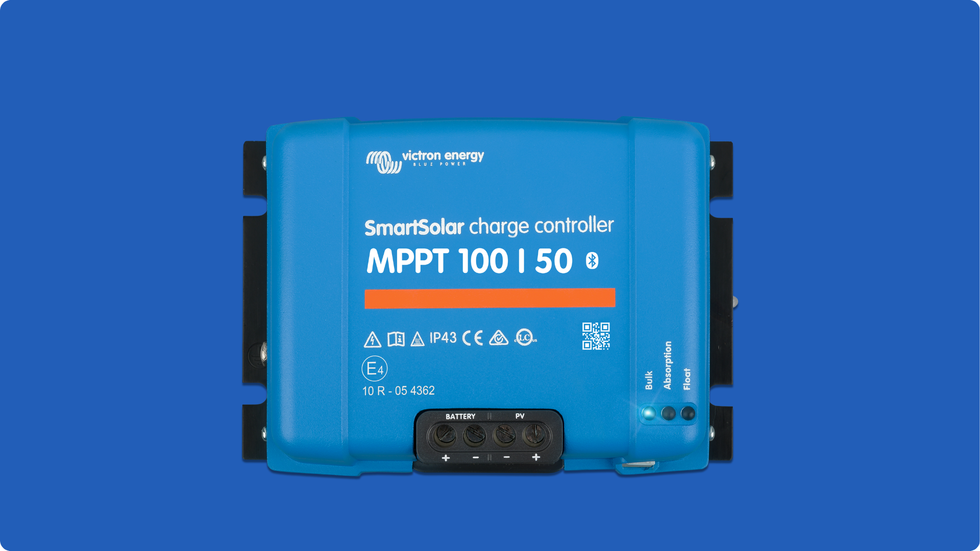

The new firmware releases for all SmartSolar and BlueSolar MPPT Solar Charge Controllers include improvements to overall product reliability, along with a few bug fixes.
