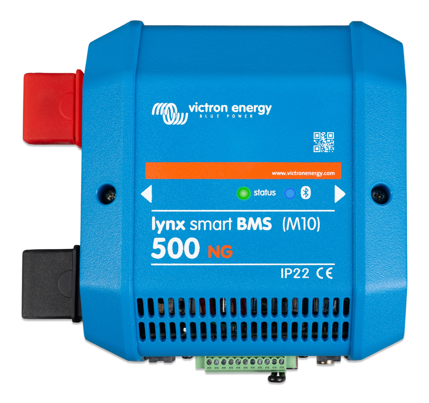

                Last month, we've released the Lynx Smart BMS (NG) v1.14, introducing various improvements and bug fixes, including updates specific to the NG series.
Key Fixes & Improvements
- More accurate State of Charge readings and improved the synchronisation (jump to 100% SoC) between the battery monitor and charger control.
- Updated Voltage Settings:
	- Default charged voltages are now 13.9V / 27.8V / 41.7V / 55.6V. Devices using the old 14.0V setting were updated automatically, which will help the State of Charge sync to 100%.
- Float voltage levels are now 13.5V/ 27.0V/ 40.5V/ 54.0V (depending on system configuration), aligned with the values in the manual.
- Fixed the alarm relay that did not activate on high temperature alarms.
- Smoother transition to float stage when used with Multi/Quattro, allowing the system more time to stabilise at the float voltage.
NG Series Improvements:
- Fixed repeated absorption timer (default is once every 30 days)
- Added cell-ID information for minimum and maximum cell voltages and temperatures, now visible in VRM /requires the latest GX beta firmware).
- Added a data loop test to validate the communication interface:
	- When a loop cable is connected between the battery BMS connectors, the BMS will close the contactor, but charging and discharging remain disabled for safety.
- The contactor will not close if the interface is not working. This test runs automatically.
