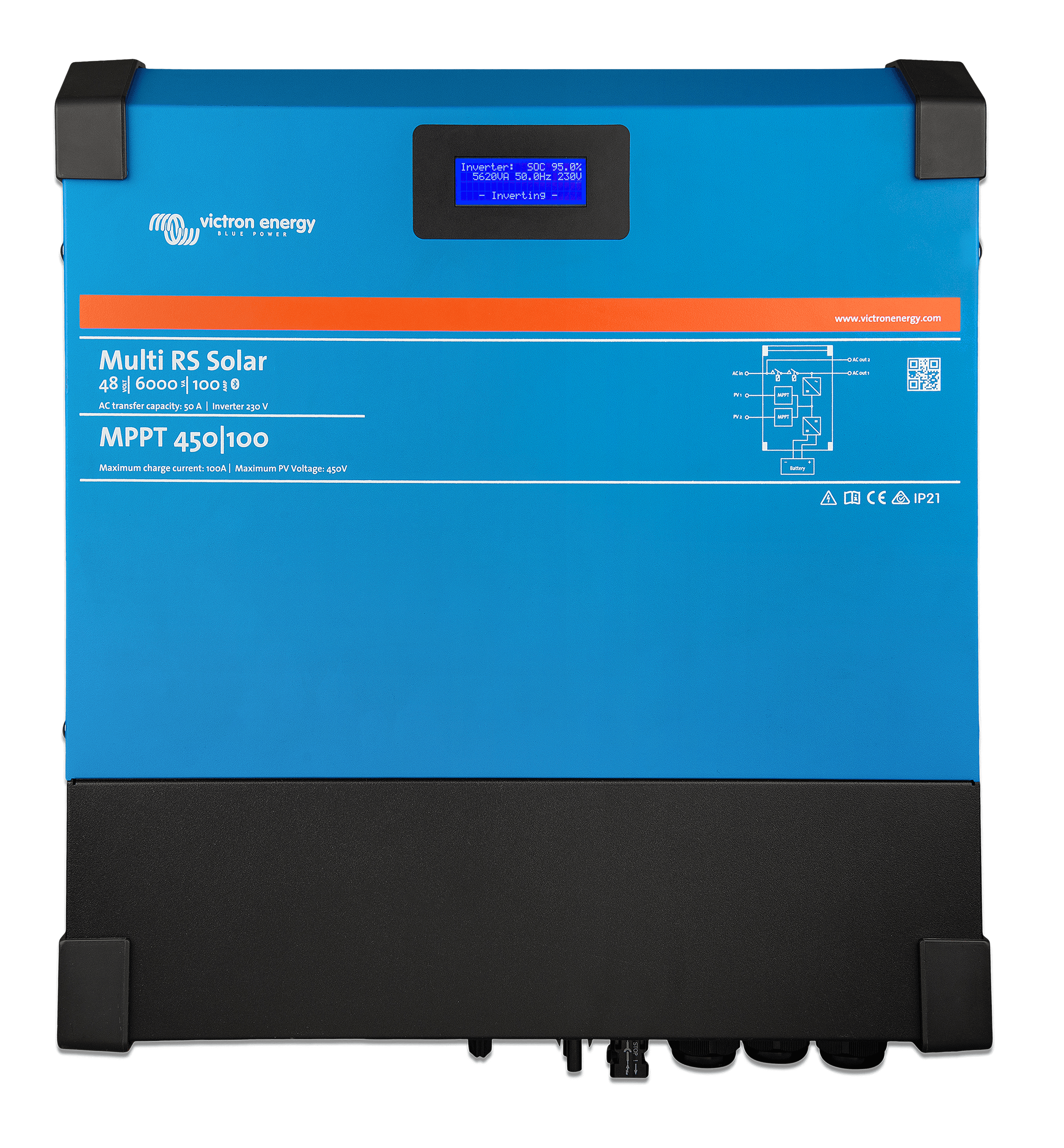

This feature allows a Multi RS to be installed without a battery, with the option to add one later to provide backup power or enable Dynamic ESS features.
Note that Energy Meter support is not compatible with this mode, and Multi RS cannot be used as a PV Inverter in installations where zero feed-in or Dynamic ESS control is required.
Make sure to use the latest VictronConnect version to enable this feature under Settings > ESS > ESS mode > PV Inverter only (without batteries) on the Multi RS device.
Another useful improvement in this update is that 3-phase systems now stay connected to the grid during firmware updates.
For more information, including the manual and datasheet, visit the Multi RS Solar product page.
