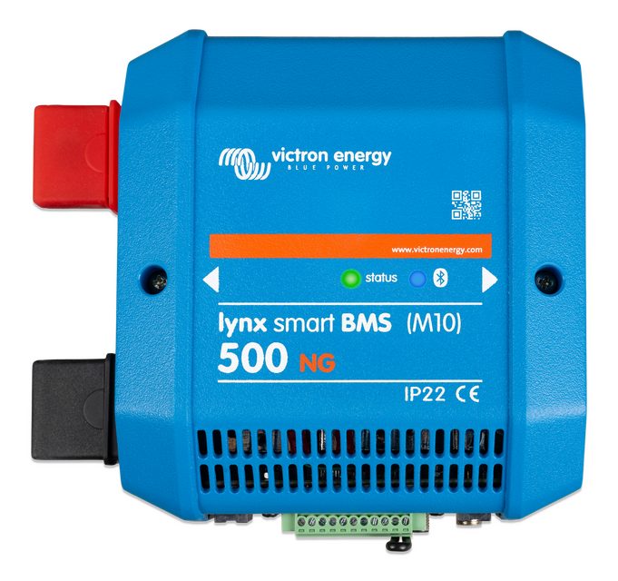

Today, we have released firmware v1.13 for the Lynx BMS NG after extensive testing. This update improves system stability, particularly for systems with multiple Lithium-NG batteries, and includes minor fixes. Please refer to its changelog for the full list of updates.
How to install this update?
For systems connected to the VRM Portal, the recommended method is to use the VRM Remote firmware update feature. Detailed instructions can be found here. For more information on the VRM Portal, visit here.
For systems not connected to the VRM Portal, we recommend waiting for the next version of the VictronConnect App. This version will include the updated firmware and will automatically prompt you to update upon connection. If you prefer to update before this version becomes available, you can download the firmware file from the firmware library on Victron Professional and use the VictronConnect App self-supplied file update method.
